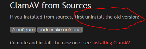

If you are updating from source code, go back to your your SRC directory and run make uninstall.
This should remove the now out-of-date libclamav libs and symlinks from the previous version install (usually in /usr/local/lib or /usr/local/lib64).
From the horses mouth..:rolleyes:
