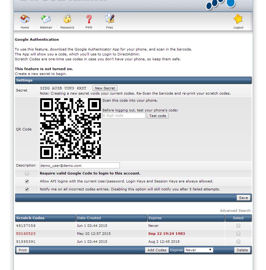

Screenshot:
http://www.directadmin.com/images/google-auth.jpg
This requires that your server and phone are both correctly synced with an accurate time.
If you server doesn't run a daily ntp or rdate cronjob, you'll want to do that, as servers do drift over time,
which is why I've set the google_auth_discrepancy=1 by default, to allow 30 seconds grace in either direction.
FYI: the demo "secret" never changes, but does work.
You can scan that QR code into your phone and you can also use the "Test Code" button to test out the provided code.
John

Thanks for the info. I've updated it without the "Google" branding. (note, filenames & commands have changed, if you were already editing things)
Basically swapped all instances of "google" with "twostep".
