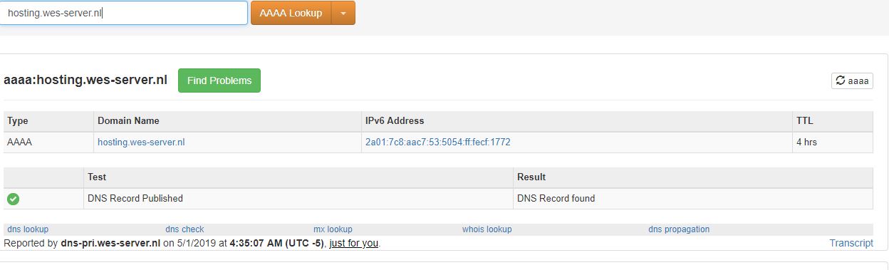

Your server does not seem to be available over IPv6. You need to fix it.
huh?
Yes, either remove AAAA from DNS, or add IPv6 into Directadmin at admin level and adjust firewall.
