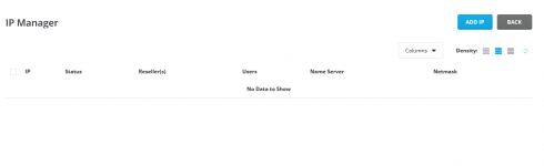

I'm trying to setup Admin backups and I'm getting the error below. I definitely have an IP and everything is working ok regarding websites, etc. Any tips? I'm running the latest everything with nginx/apache.
Edit..also, the IP Manager area is empty...
Nevermind. Here's the fix.
I added the IP to the Admin view by simply typing in the server public IP inside...
/usr/local/directadmin/data/admin/ip.list
Then I created a file at /usr/local/directadmin/data/admin/X.X.X.X where X.X.X.X represents the public IP. i.e. If your server IP is 192.0.24.53 then the file would be called /usr/local/directadmin/data/admin/192.0.24.53
I can get into the Admin Backups area now.
The IP list is empty that's why you got the error. Why not just add the IP through GUI? It's the button 'Add New IP' you just screenshot here.
But if you need to add IP manually for other reasons (eg. for scripting) read this: https://help.directadmin.com/item.php?id=417
Then, remember to run this: ./build rewrite_confs after you changed the IP manually by modifying the file to generate host configuration file. I posted the information here about this (not documented in DA):
That was actually the first thing I tried but failed to mention it in my initial post. When I added the IP via the GUI, the entire DirectAdmin portal went white and I could not log in or refresh the page. Luckily, the websites continued to work. I had to reboot the server to get it working again and when it came up after reboot, the IP was no longer in the GUI. That's when I created this thread.
