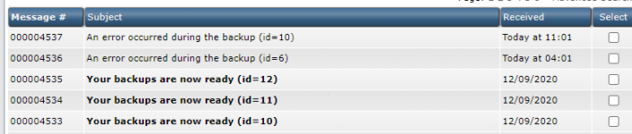

Hi. Yesterday I ran the available updates in custombuild. Last night the admin backups failed to our remote FTP backup server. Error code in Directadmin:
Please see this URL and check for curl exit code '(67)': https://help.directadmin.com/item.php?id=2127
User XXXX has been backed up. <11:00:03>
ftp_upload.php exit code: 67
ftp_upload.php output: curl: (67) Access denied: 530
curl return code: 67
FileZilla error:
USER test << So user hits FileZilla...
530 This server does not allow plain FTP. You have to use FTP over TLS.
The backups worked before yesterday's updates, so I'm assuming it has something to do with them. A cURL update was also in the list if i'm correct.
The error appears when either is enabled:
- "Disallow plain unencrypted FTP" (Settings level)
- "Force TLS for user login" (User level)
So the backups work when both are disabled.
The DirectAdmin FTP backup setting: Secure FTP: FTPS
Any ideas?
