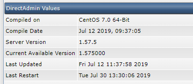

I tried to upgrade DA to newest version (1.575), yum update and rebuild everything (./build all d),
I check binaries thing too (compiled on Centos 7)
But everytime i tried to use Admin Backup/Transfer then it'll never show the result in Message System
(User's System Quotas setError locking the User 'admin' actions lock file due to existing lock. Some other process may be doing work on this account)
When i check backup proceed in Admin Backup/Transfer it will stop imediatly (After click into Details),
it's shown "Overview PID is not currently running, Cleaning up tracking information. Tracker stream has closed."
I tried to use /usr/local/directadmin/dataskq d2000.
