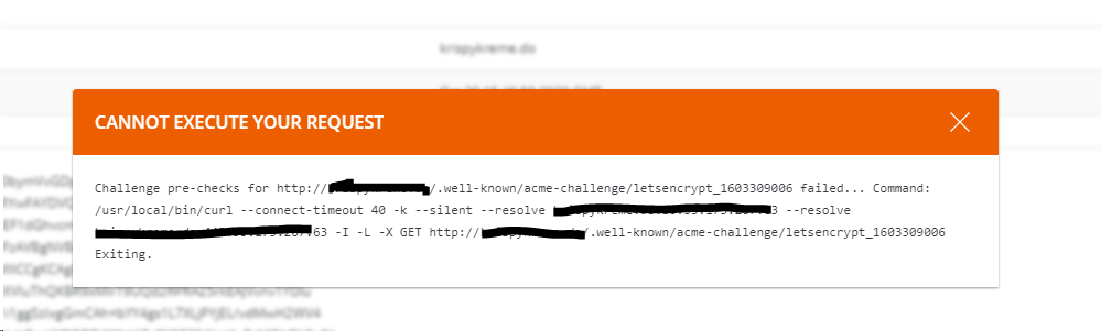

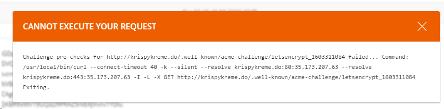

can not use Let's Encrypt ssl
Do you have Force SSL turned on for that domain?
When you enabled SSL there is a checkbox with Force SSL. Do you have that checked?
You should not have force on until AFTER you have a certificate.
thanks for reply
i use Free & automatic certificate from Let's Encrypt
i think it is no need to get the certificate
When you use Let's Encrypt you are "getting" the certificate. Do NOT turn on Force SSL until after that is done.
Now that you have force https turned off try it now. It will not be the same error. Post the error here.
Thank for you help. I fix the problem.
Solution: My domain DNS was pointing to another server. When the system try to renew the certificate it get and error because it can't copy the Challenge in the remote host. What I did is change the DNS entry to point to a local host, recreate the certificate and perfect, it work. Then I change back the DNS to the remote host. Now I will need to renew the cert manually because there's no way in the remote host.
If some body know how to automate this task, I will be glad.
Thanks,
