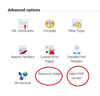

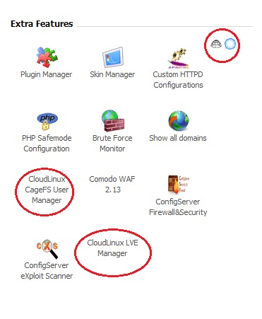

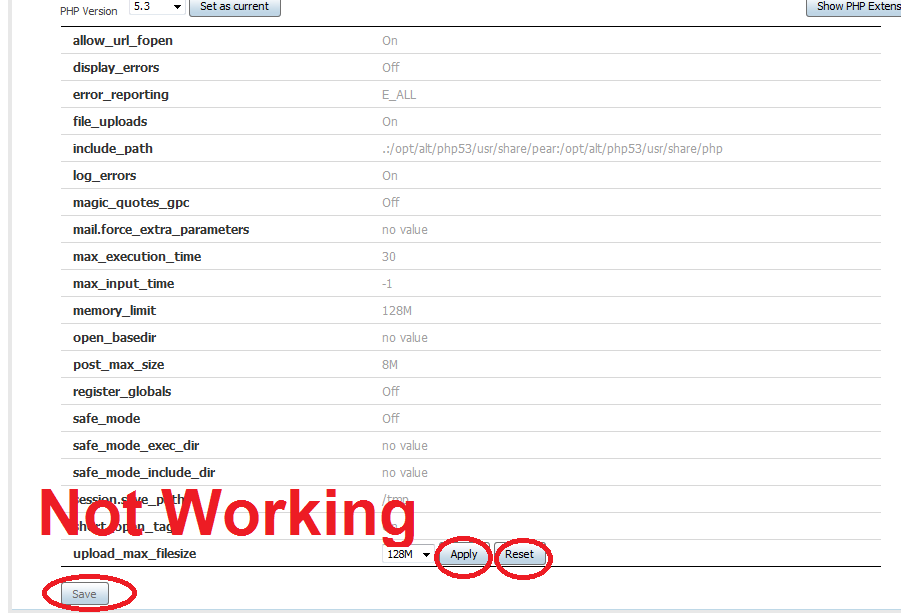

Hi
This skin is not working with cloud Linux correctly
Icons is not show and some Buttons is not working
Please see the attachments
bit
Apr 23, 2015
57
Hi
View attachment 2110View attachment 2111View attachment 2112
I think problem with not correct hook/admin_img.html and hook/user_img.html for you plugins. Please look analogy request (in comments) for another plugin - https://github.com/Terrorhawk/Capri/commit/baa8b885ea0179153c103a688463633b03af51e2
I dont have this plugins for give you more information.
The php selector feature was added to DirectAdmin 1.431 (in cb 2.0). More information here: http://www.directadmin.com/features.php?id=1456
Look screenshot - http://s012.radikal.ru/i319/1510/18/f55c88022e2f.png
If need i can add icon with link to this menu for main user menu in next release.
P.S. Please in future all bug request send to github issues - https://github.com/Terrorhawk/Capri/issues
