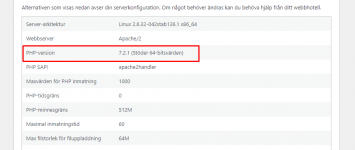

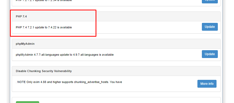

I have changed the PHP default version from 7.2 to 7.4 using CustomBuild. It saved correctly and showing version as 7.4 in CustomBuild window. But my actual apache PHP version not updating even after restarted apache. Please help me to update this.

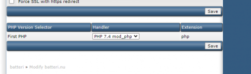

Looks like you have multiple PHP versions installed. In this case, under Domain Setup > your domain, at the bottom of the screen you should see a PHP Version Selector where you can switch between PHP versions.
Thanks for your quick reply. But my default PHP version is 7.4. So it is automatically selected as 7.4 under
domain setup. But in my site server details still showing 7.2.

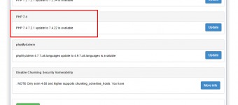

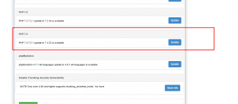

Did you click "update" button? Did it throw any errors?
Thank you for your response. When clicking update button it showing as done in terminal, but actually not updating.
