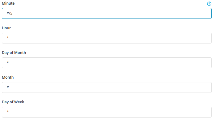

Hi. Just want to check, will the following run every 5 minutes or once an hour on the 5th minute?
If it's not running every 5 minutes, how can I make it so?

I know how to do it with a script but I'm curious only about DirectAdmin's approach. I guess the settings in my screenshot are correct for what I'd like to do.
It'd be nice if there was a "Next Run:" feature on the page.

Actually, my screenshot is not the correct way to do it. To run a cron every 5 minutes, I'm pretty sure either of the following would work:
