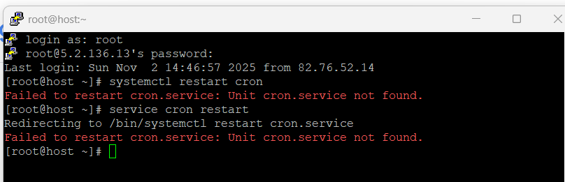

How can I start/restart/ install cron service?
There is something wrong here.
It's not cron service it's crond service.

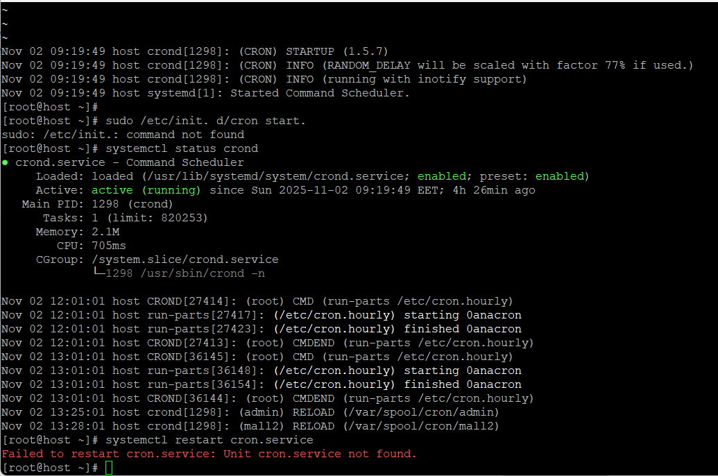

Check if it's running like this:
systemctl status crond

So that means the crond service is running and enabled on startup (so after start or reboot) and cron tasks should be executed.

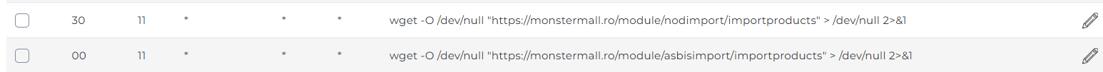

Is it a backup cron or something which is running daily or which kind of cron? Can you post one of the crons which should be running and which is not running now?
