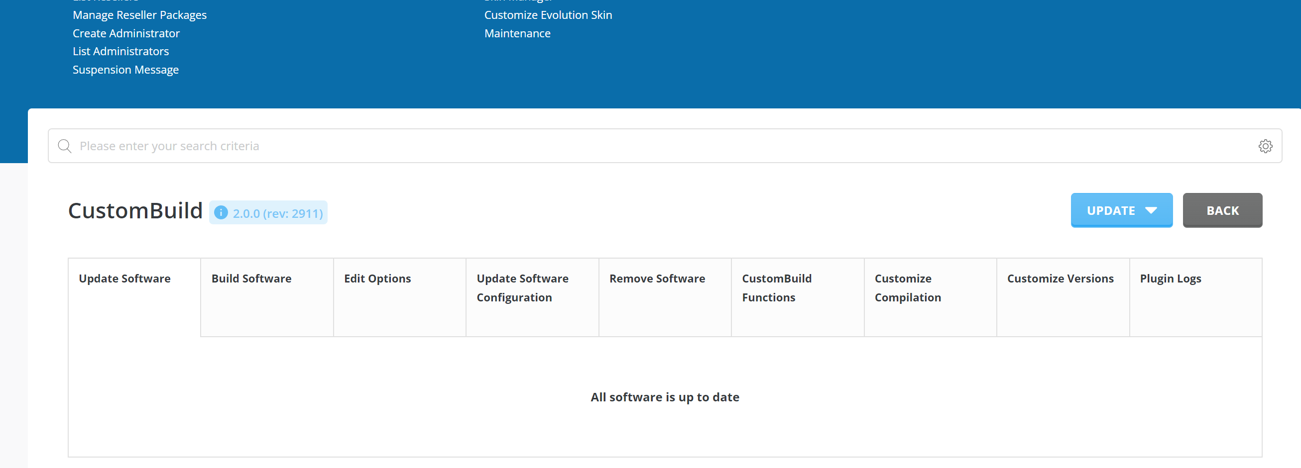

I put 157.90.223.115 whitelist (allow, ignore, unblock) in csf.
Look like now it connects:
