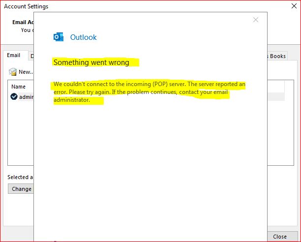

I Connected to Outlook the outgoing emails are working but incoming email only connects to 995 if I connect to the 993 port it's showing.
So I can't receive emails but if I open the same email using Roundcube I foud the emails that i am supposed to receive !!

I Tried using Spark email client I choose SSL connection for both IMAP PORT 993 & SMTP PORT 587 (BOTH ARE OPENED IN THE FIREWALL)
It's showing a stable connection could not be established! so i tried choosing the option StarTTLS still showing a stable connection could not be established!

I Already fixed the problem csf blocked my IP but ports still I can't connect to my emails via spark as it is not reading the SSL
So you also fixed the exim syntax error? Good.
Does your mail work without SSL like I asked? So by using port 110 for pop?
It works on Outlook using Port 993, 465 but not any other email client that uses IMAP/SMTP AT ALL, Outlook works using pop
