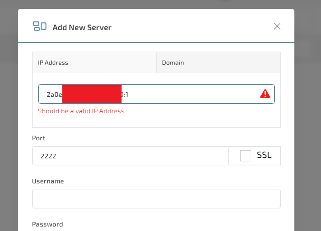

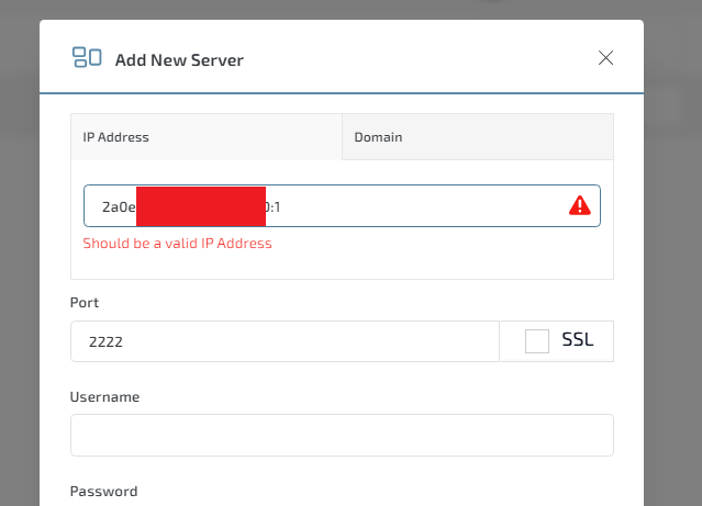

IPv6 input in Multi Server validation still broke,

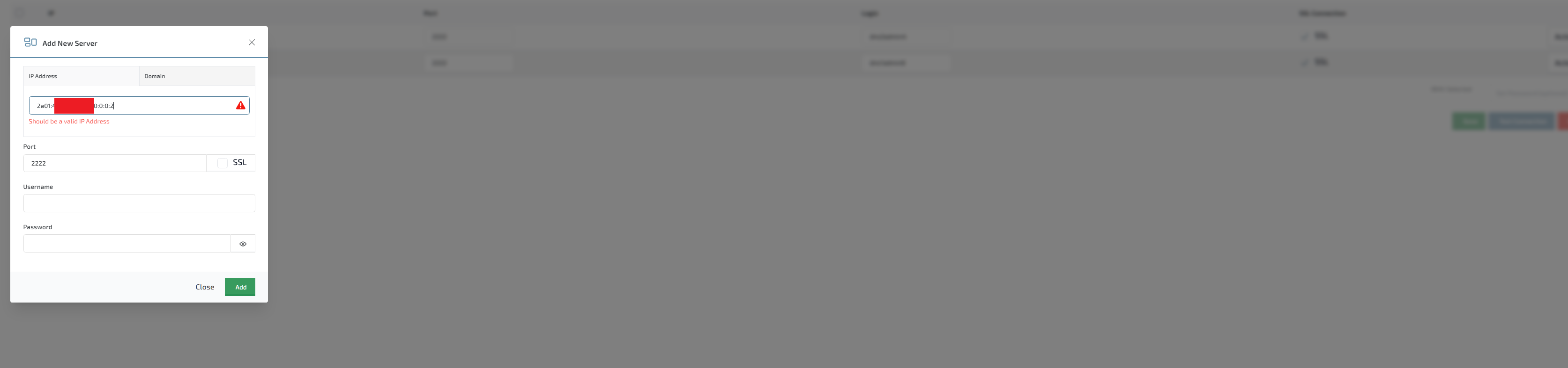

Also error messages and input boxes appear at the far left now. Is this a feature or is something broken in the CSS?

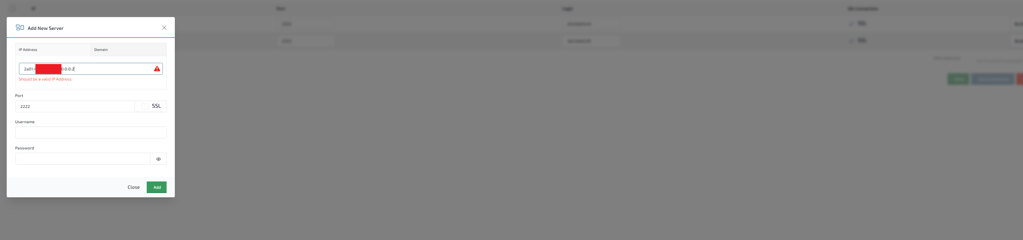

1. IPv6 for MSS - confirmed.
2. The issue with boxes - is not confirmed on test DA servers. Please provide some additional details:
- exact OS and its version;
- exact browser and its version;
- any other useful information.
Thanks for replying @romans , Ignore that one (From me, at least) as i've got a bit of custom CSS styling that was conflicting with a change that was made. All sorted now
Apologies if that caused you guys any issues.

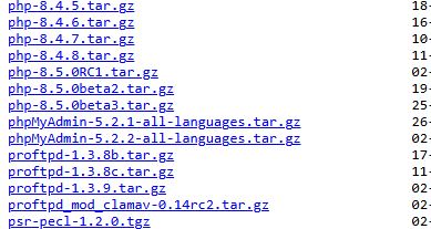

Custombuild phpMyAdmin Update gives an error, seems the file is missing:
curl: (22) The requested URL returned error: 404
safe_download: downloading 'https://files.directadmin.com/cache/phpMyAdmin-5.2.3-all-languages.tar.gz' to '/usr/local/directadmin/custombuild/tmp/tmp.XSSAXThH4p.safe_download' failed
Its definitely missing from that url buddy.

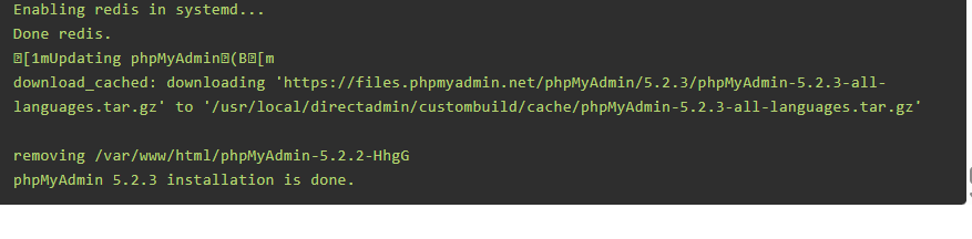

which is very strange as I updated 3 of my servers last night with the new release and the phpMyAdmin update worked perfectly. Looks like they've made an error in a line somewhere as my install came down from https://files.phpmyadmin.net/phpMyAdmin/5.2.3/phpMyAdmin-5.2.3-all-languages.tar.gz
"https://files.directadmin.com/cache/" path is using in case if "https://files.phpmyadmin.net/phpMyAdmin/5.2.3/phpMyAdmin-5.2.3-all-languages.tar.gz" upstream is not available from your location.
It seems there were some problems with updating "cache" path with PMA 5.2.3 package on our site.
But it should be OK later today (till the end of the day).
