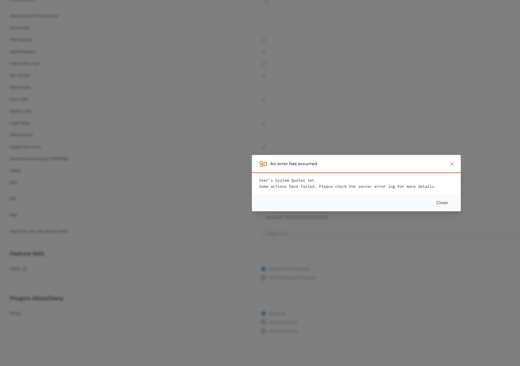

I am getting the error "User's System Quotas set
Some actions have failed. Please check the server error log for more details." when changing the configuration of a user account after upgrading to 1.690. Please guide me how to fix this error
Also problems with suspending and unsuspending users. It gives the error "Some actions have failed. Please check the server error log..."
After f5, it works, but these are not comfortable warnings from DA.
@cautroi, @toktokcity, please open a support ticket. This will give us a chance to check out the reason for the errors.
This DA release treats some previously ignored warnings as errors. More details about the error should be in the service logs.
Thanks.
A new build for this DA version is released. It includes the following fixes:
  • Added compatibility code to avoid having to rebuild openlitespeed right after update. Thanks @toktokcity and @johannes.
  • Fixed the surplus error message when modifying user. It was caused by failure to disable per-user redis service on servers where per-user redis is not used at all. Thanks @cautroi and @toktokcity.
