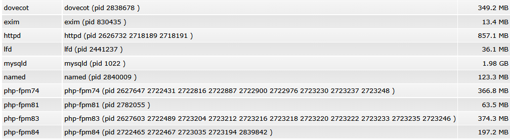

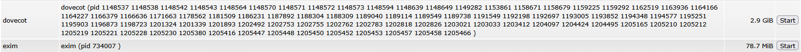

The new update version 1.693 introduces changes to the Service Monitor manager.
After updating servers to version 1.693, when monitoring via Service Monitor, Dovecot generates a very large number of PIDs.
Meanwhile, on servers running versions earlier than 1.692, Dovecot usually shows only one PID.
Additionally, the number of Dovecot PIDs keeps increasing continuously, and RAM usage becomes very high.
In contrast, PHP-FPM in version 1.693 shows only one PID, whereas in earlier versions, PHP-FPM would spawn multiple PIDs.
Has anyone experienced the same situation as I have?
Could you please share how to handle or resolve this issue?

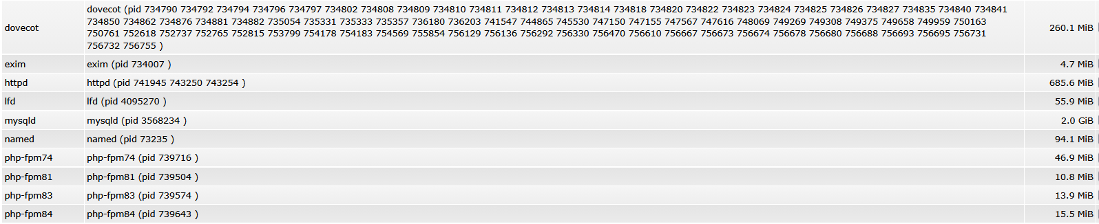

@ViT, latest DA release tracks services in a different way (most of the time more accurately). Information about processes and memory usage are now retrieved from the systemd. This means most of the services are being tracked more accurately. For example, the Dovecot process entry in System services page now includes all dovecot sub-processes (like lmtp, pop3-login, imap-login, ...).
When the PHP-FPM master process starts a pool worker moves out the worker process to a new cgroup slice and systemd starts treating it as external process and no longer includes in the list. That is why it only lists one process now.
Old DA used to go through process list and try to guess which process belongs to which services.

@fln
May I ask whether the current Dovecot statistics in the new version accurately reflect the services that are actually being used?
After updating, the reported Memory Usage for Dovecot is always much higher than before the update.
Previously, Dovecot typically showed average memory usage of around 300–400 MB. However, it is now reported to have spiked to several times higher, exceeding 2 GB, and this behavior is consistent across all three servers where I upgraded to the new version.
We have also reviewed two large boxes with a high number of users, and observe that Dovecot is indeed consuming a significant amount of memory there as well. I am unsure whether this was also the case in the past.
