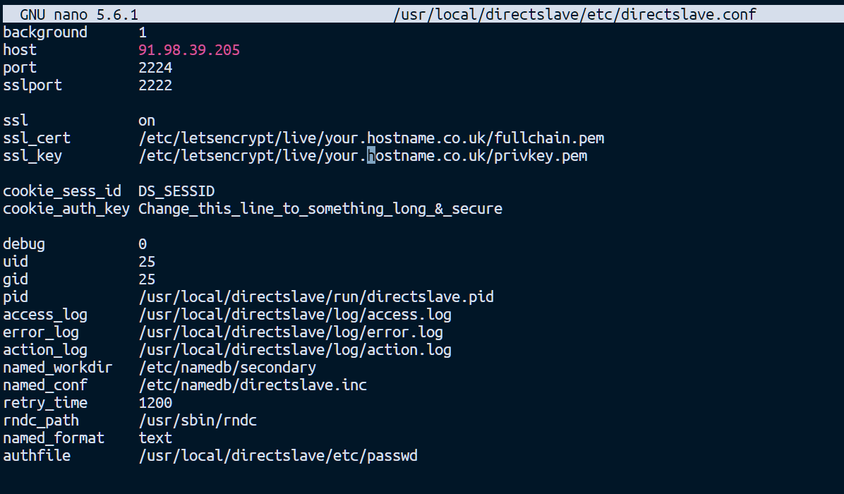

Now we need to edit the directslave.conf file. I opened port 2224 above in case I need to have plain HTTP and not HTTPS, but I prefer HTTPS when I have a hostname. If you are NOT using Certbot and an SSL cert, then do not put the SSL lines in, and simply set "ssl off". Also the IP of this server is noted at the top. You can remove this if you want and set it to * .The finished file should look something like this:

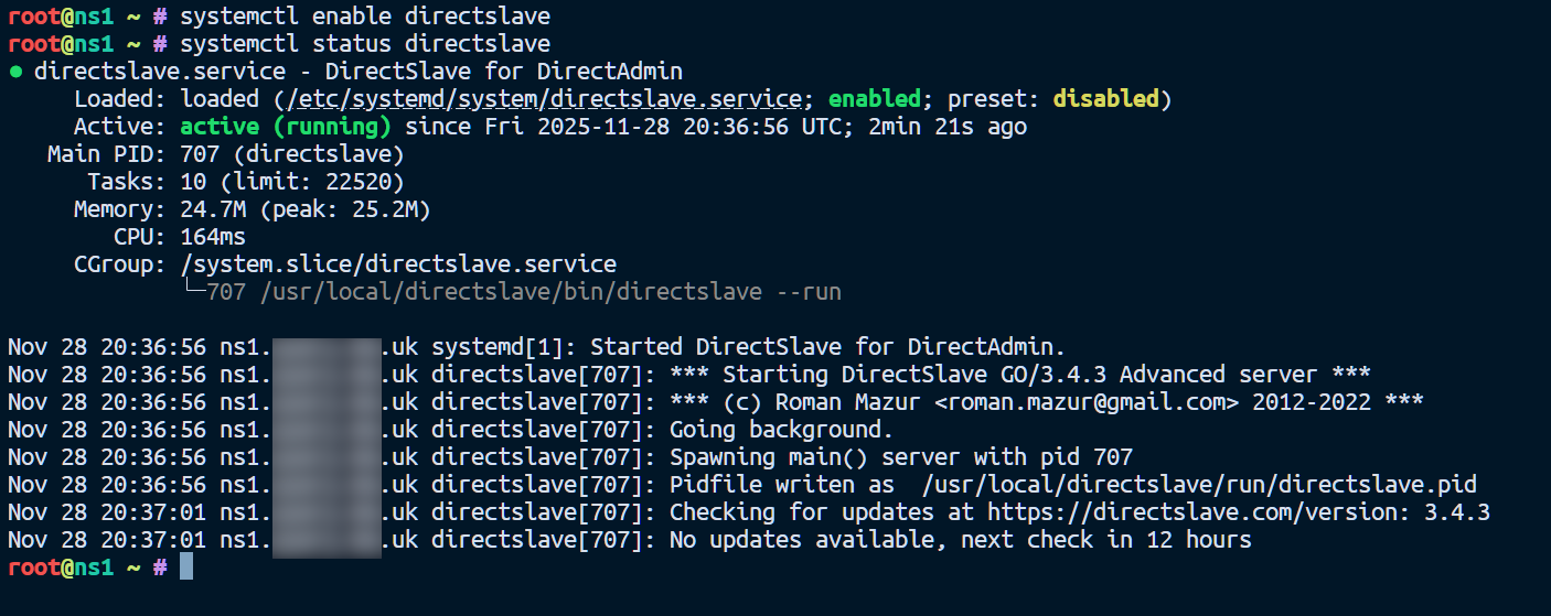

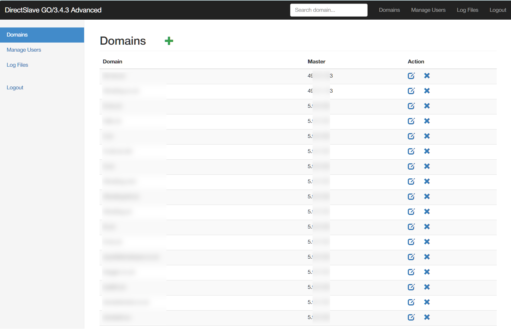

Now you can check DirectSlave is loaded and working

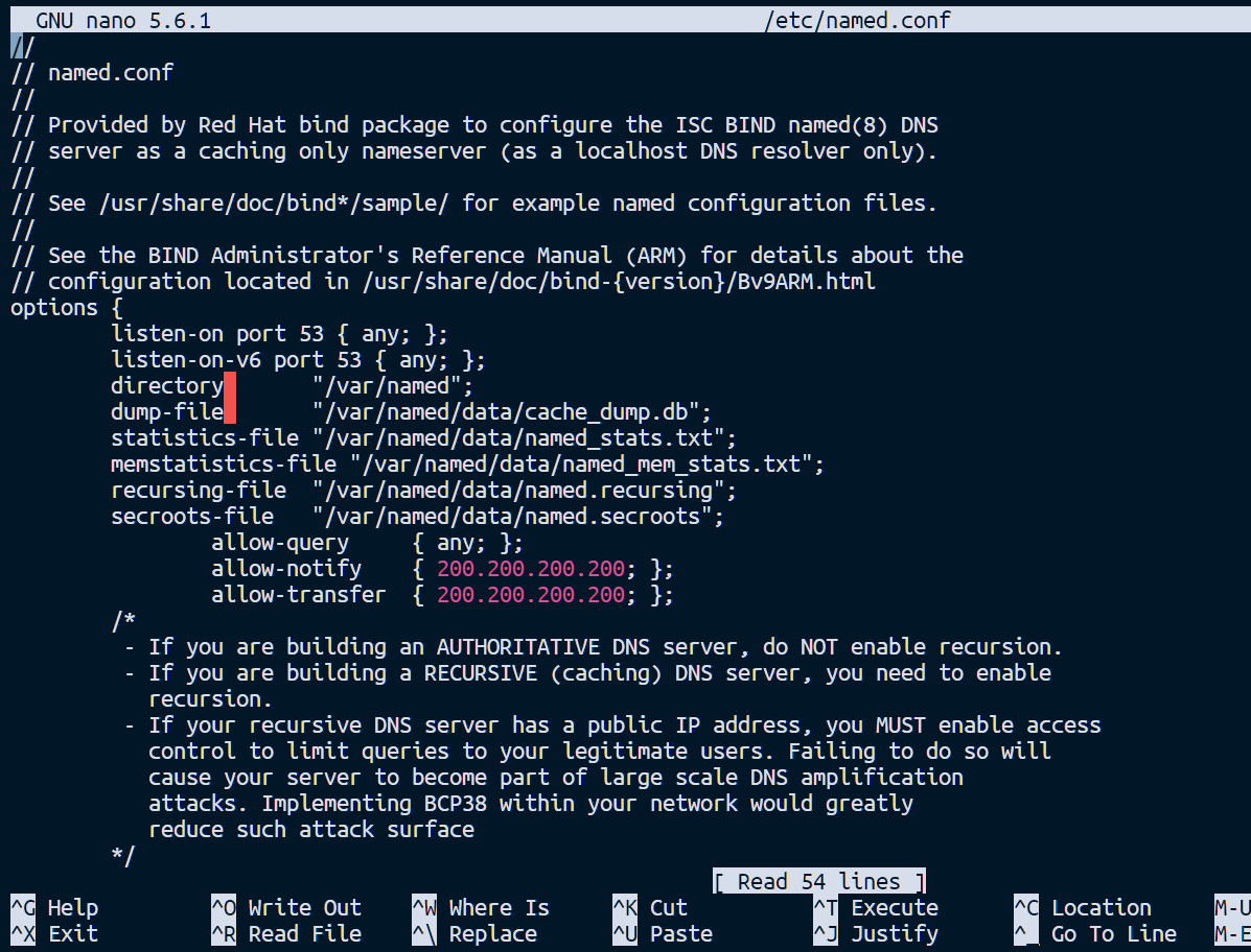

One final thing to do is check / edit the named.conf on this server. We're setting it up to allow transfers from the main DirectAdmin server. Make sure the IP address in the allow directives match your DirectAdmin server IP. Also, this is an IPv6 enabled server, so in the DNS zone for the FQDN hostname of this server wherever you have it hosted, you can also setup another NS record with AAAA, aiding axtra connectivity. In the named.conf file you would change the listen-on-v6 port 53 {} directive to { any; }; as i've done below. If you are happy with just IPv4, leave it as { none; }; In this example it shows 200.200.200.200 which is what we setup at the very beginning.

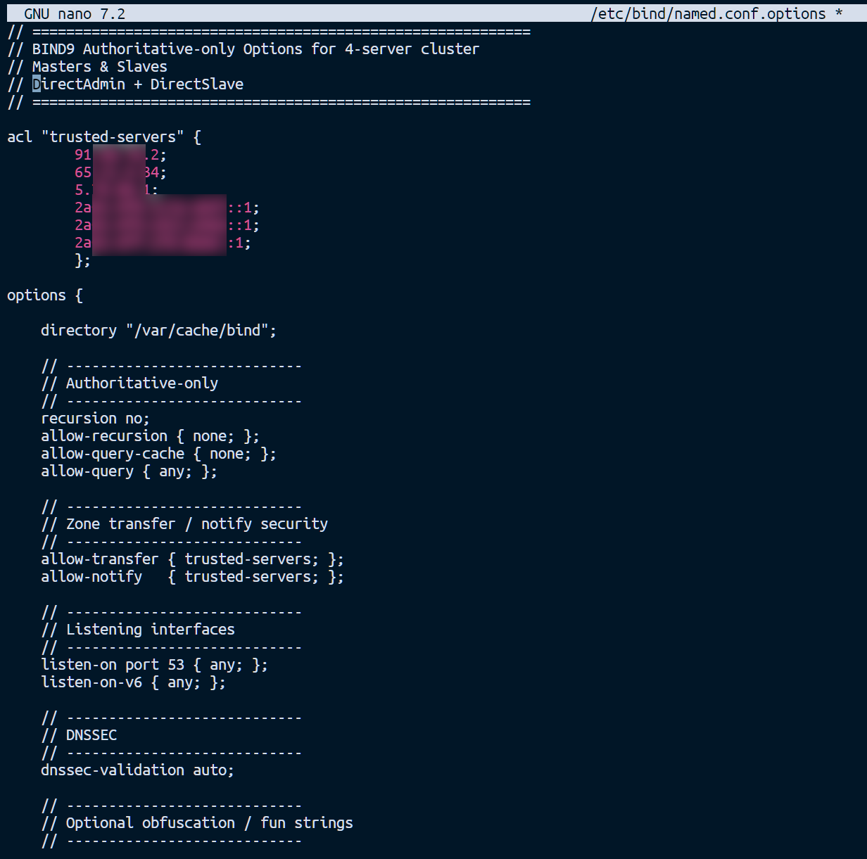

And the very last thing is to go to your Directadmin Server and edit the /etc/bind/named.conf.options. Add in the IP addresses of all your slave servers so they get authorised to receive the zones and transfers.

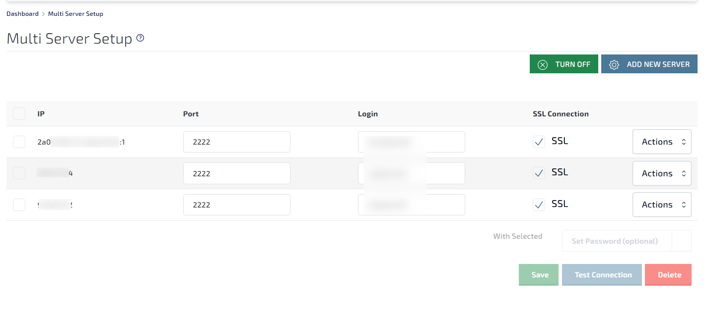

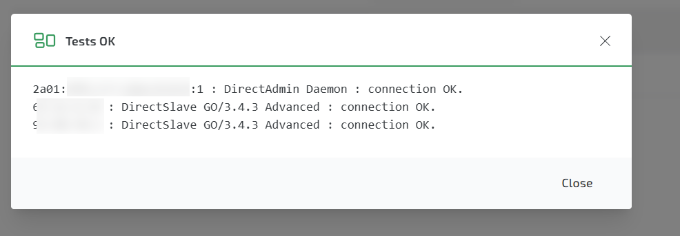

And that's about it. Go to your DA Master and setup Multi Server for the new server and check it connects ok.
If you have a new server, and you've paired it with the IP addresses in the named.conf files above, you can run the following command and it should send all the zone files to your freshly setup DirectSlave server. It'll take a few minutes so be patient. you MUST run this command from the master Directadmin Server for it to work.
Now you should have the DirectSlave server setup and working. You can have as many or as few servers attached as you like. I have the main Directadmin Server and 3 other DNS servers spotted about.
Bash:
# echo "action=rewrite&value=named" >> /usr/local/directadmin/data/task.queue
Good luck!!
