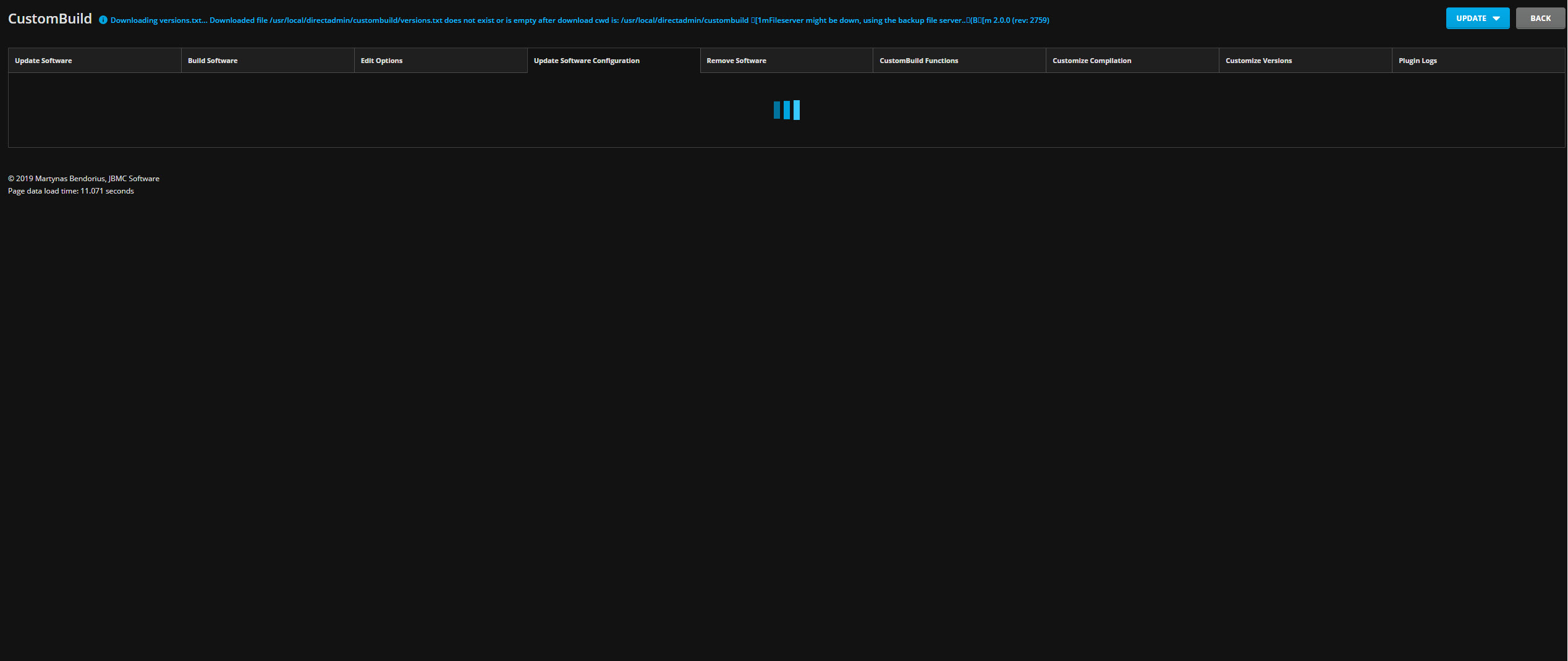

I'm having this issue for a few days now. And I'm not finding a correct way to solve it. First I thought it was the diskspace, that was almost full that was causing this. I've tried too update costumbuild and scripts, even update via directadmin plugin manager, but nothing seems to solve it.
Attached a printscreen what I see as an error.

Try another server.
Check in /usr/local/directadmin/custombuild/options.conf which server is used now.
Then issue this command from that directory:
./build set fastest
and check after that if it's another mirror. If yes, try to update again.
