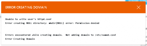

Hi all,
Does anybody know what's going wrong? It appears on 2 CentOS servers with latest DA version!
Not only by creating domains but also subdomains and renaming or move between users!
I've already checked locks by lsattr, -i doesnt help and the only flag isset e(xtends)!
What chmod and chown permissions does httpd.conf have by default? Or is there another possible problem cause failing mkdir doesn't have to do anything with it, right?

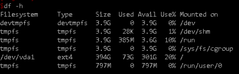

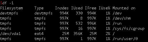

Please check:
df -h
df -i
To make sure disk resources are available.

Sources aren't the problem, did check that first and backups are running without problem so disklimit isn't a issue!

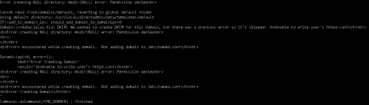

Debugmode:
/root/domains/default isn't a dir, never been right? Where could it been wrong?

Your debug output was "cut", so I'm not sure what's above the text you've pasted.
