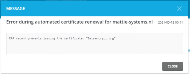

A couple of days ago I first got this message. Now trying to debug but I can't find the problem.

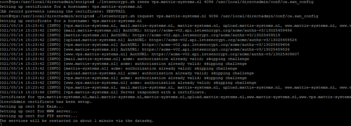

If I run the renew command manually I do see this error:
But yeah it worked before and I did not made any changes as far as I know. Any ideas?

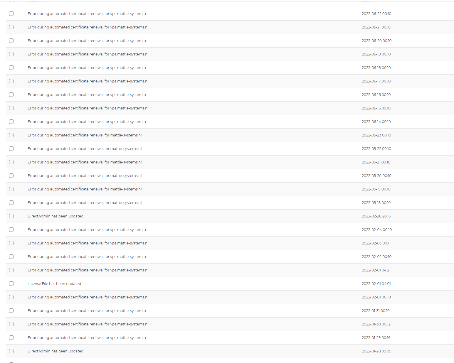

Still getting these emails but hey my certificate is valid from 14 may till 12 august now so perhaps I need to wait till the one it is trying to renew "times-out". Is there a way to see what certificate it is trying to renew? Like a list that is 'active' perhaps there is something wrong there?

And just for funs: I do still get this from time to time. Usually it fixes itself in a couple of days. But this time it does not seem to be able to fix itself. I now have 2 weeks to figure it out :)
Sometimes the error is:
CAA record prevents issuing the certificate: "letsencrypt.org"
and sometimes:
CAA record prevents issuing the certificate: SERVFAIL

So.... I was running:
[email protected]:/usr/local/directadmin/scripts# ./letsencrypt.sh renew vps.xx-xx.nl 4096 /usr/local/directadmin/conf/ca.san_config
(as found in my history :p)
And every time: SERVERFAIL
I thought let's add some 'echo' to the script so I can perhaps see what it does. And then after a couple of echos:
Yeah so I still don't understand this -_- but at least it is fixed again. Pft.
