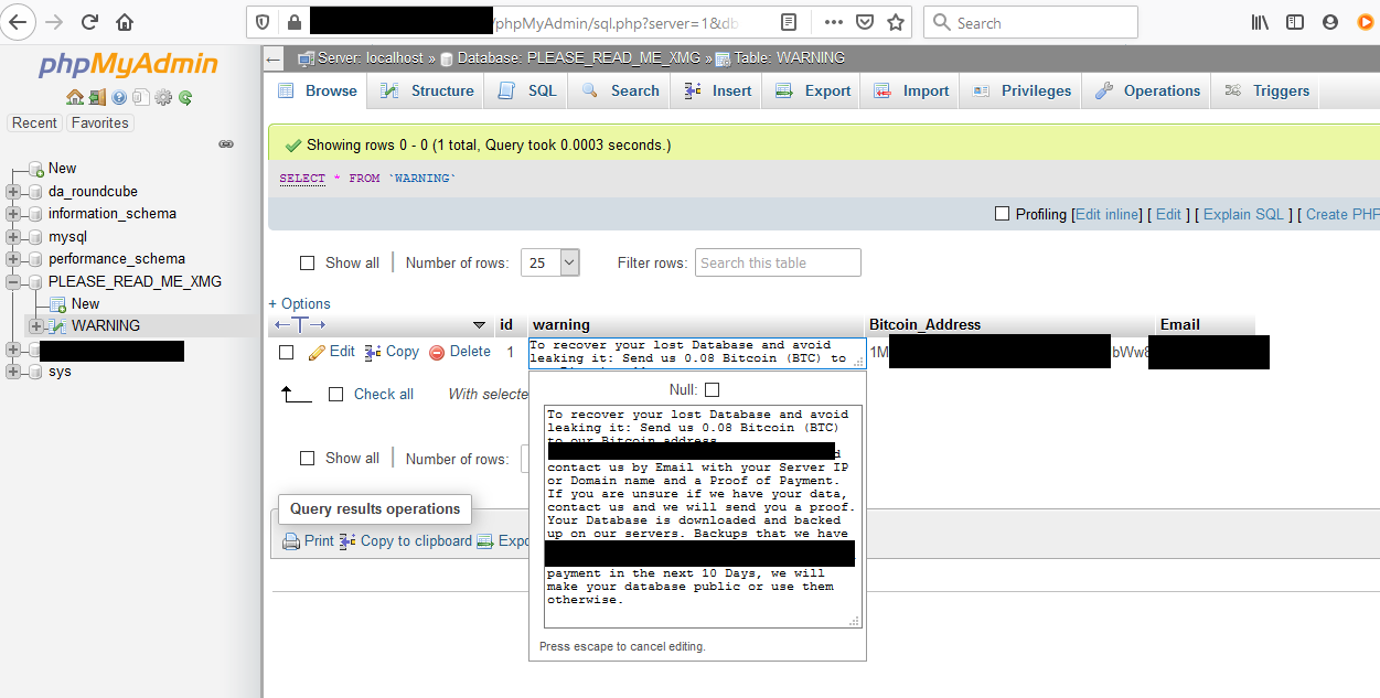

Hi all.,
I want to discuss to anyone who have experience about this.
my customer got database gone. by hacker big database around 100g
absolutely hacker need bitcoin from me, see photo
How to protect ?

They either removed existing tables or encrypted them, and created a WARNING table
/var/lib/mysql/user_db/WARNING.frm
/var/lib/mysql/user_db/WARNING.ibd
with the following content:
To recover your lost Database and avoid leaking it: Send us 0.06 Bitcoin (BTC) to our Bitcoin address 1BLYhU********cTWgc6gFT6DCYwbVieUD and contact us by Email with your Server IP or Domain name and a Proof of Payment. If you are unsure if we have your data, contact us and we will send you a proof. Your Database is downloaded and backed up on our servers. If we dont receive your payment in the next 10 Days, we will make your database public or use them otherwise.
I've masked the Bitcoin address.
In certain cases we could see files like:
 /var/lib/mysql/mysql/\usr\lib64\mysql\plugin\\cna12.dll.
with various names under /var/lib/mysql/, they probably utilized LOAD DATA statements to gain a privileged access to a server.
