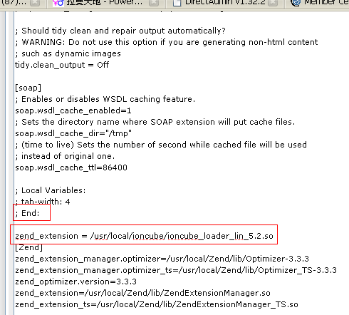

from phpinfo() it is PHP Version 5.2.5
Then you must use "zend_extension = /usr/local/ioncube/ioncube_loader_lin_5.2.so", add this line after "End:".

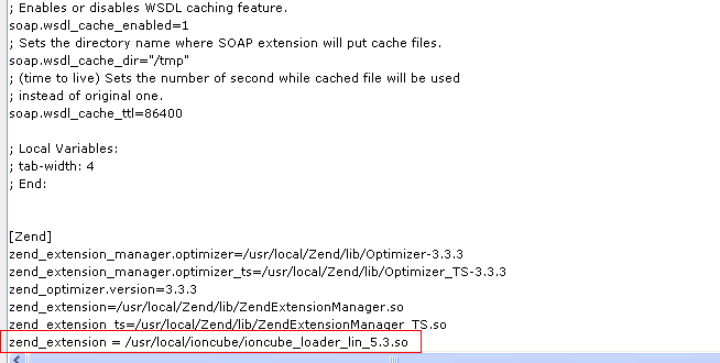

i have do like the printscreen..
but when i check from phpinfo, i not found there is ioncube installed.
Not 5.3, but 5.2. And you should see it in "php -v", and I told you to add it after "End:", not after zend optimizer.
