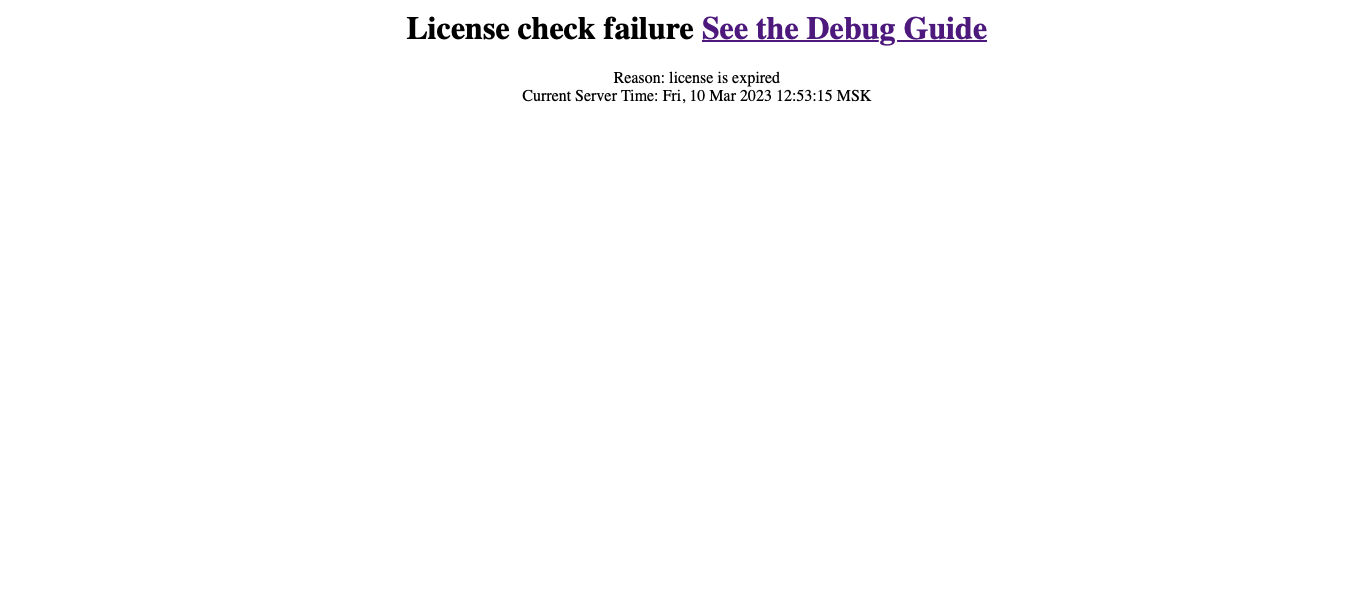

Hello, I get an error several times a week when logging into directadmin.
To fix it, you have to do the following -
/usr/local/directadmin/scripts/getLicense.sh YGUZx8a1+xxxxxxxxxxxxxxxxxxxxxxx (Example)
Can you tell me how to get rid of this error?
My guess is that you or somebody else use the same License Key on different servers. You might set an IP restriction in a client area at directadmin.com to allow the license key to be used only on one server.
