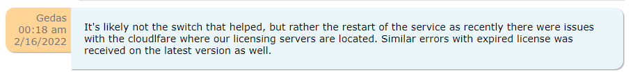

I got this reply from Gedas
I am still not sure if it was the issue Gedas reported or is a bug.

That explained that we saw the behaviour on random servers, that connecting to the licensing server was impossible for a while. I hope this can be prevented.
solution that worked for me even when I was using the Latest DA vesion.
Change DA channel to STABLE if using CURRENT 'or' CURRENT if using STABLE.
