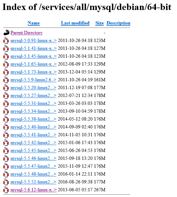

I have tried to update mysql for some time now but it dont work.
I get the error.
Failed to download http://files.directadmin.com/services/all/mysql/debian/64-bit/mysql-5.6.34-linux-x86_64.tar.gz. Exiting...
If i look into the directory i cant find the file the update tries to find. It's not in the directory. How to solve this? any ideas?
Best regards
Jukka
Hosting Kernel
Sep 30, 2015
133
try to use diff download server, edit /usr/local/directadmin/custombuild/options.conf, then set downloadserver=files9.directadmin.com
THN Data
Jun 2, 2013
38
The easiest way to fix this was to migrate to MariaDB instead.
Worked flawless with the Custombuild plugin.
So all good again.. Perhaps also a good idea to migrate over anyhow.
