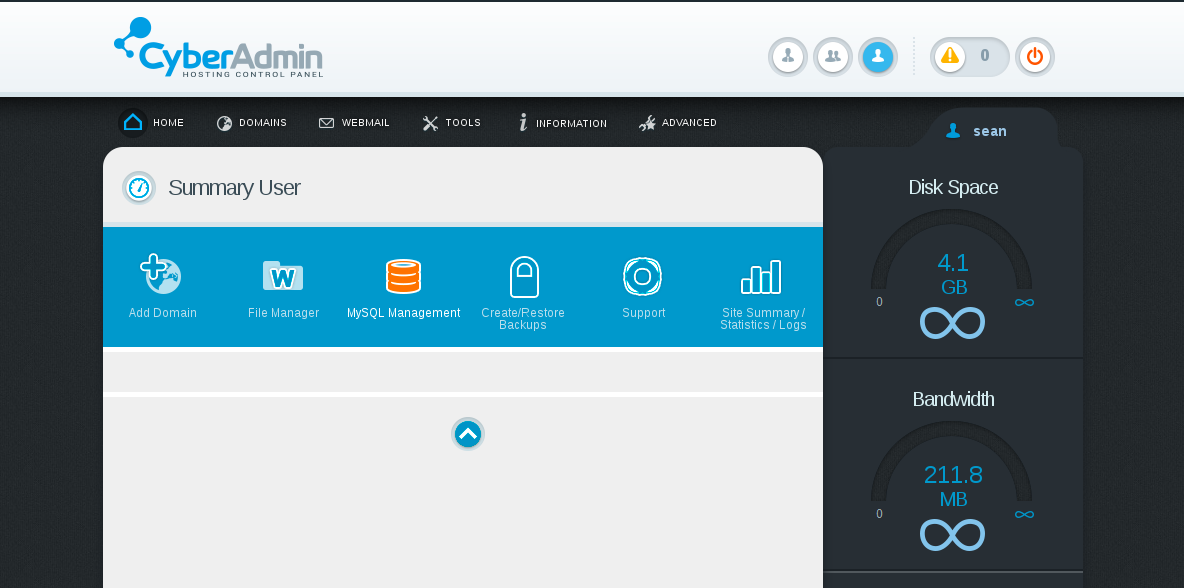

Ok.. Why can't I see anything when I click user mode? No installatron, no nothing..
Probably you have configured the bind_address property in the directadmin.conf file. CyberAdmin makes internal api calls and require access to localhost (127.0.0.1) to work properly.
Try to comment bind_address in directadmin.conf.
Regards.
r3chn3r
Jan 13, 2013
139
Regards.
Nope.. No bind_address value at all in directadmin.conf
Any other ideas?
