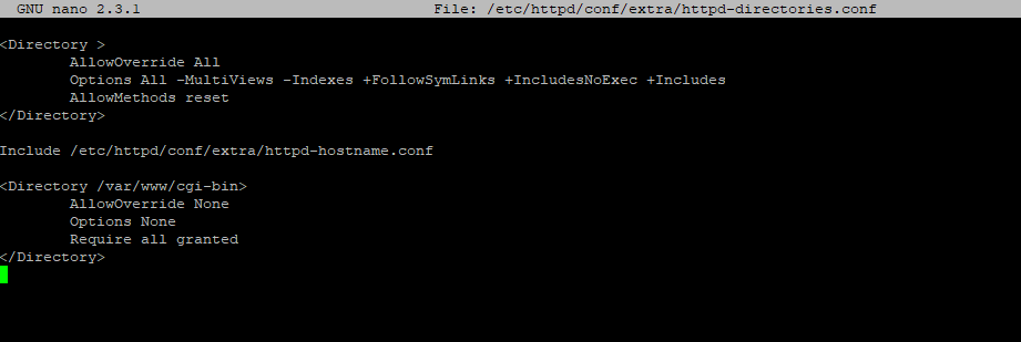

Directory home is default for my vhosts.

Do you have either of the following set in /usr/local/directadmin/custombuild/options.conf for these servers?
harden-symlinks-patch
secure_htaccess
secure_htaccess
I have only harden-symlinks-patch=yes
i rebuild apache and httpd conf, same problem.

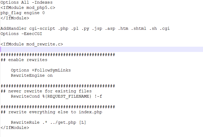

My httaccess

ExecCGI option cannot be controlled, unless CGI-BIN is enabled for the user. Just take that line out if it's causing issues, it's disabled anyway.
Regarding "All" - not needed there as well. "Options -Indexes" is enough (it's default, so, even this is not needed).
