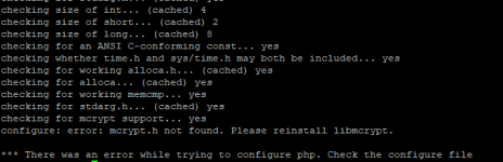

Hello guys,
Today I'm trying to install DirectAdmin.
I have all the components (installed by guide directadmin installation)
The solutions I found every one to install yum install pcre-devel but I did !!
While it is installing:
OS: Centos 7
Try:
./build update
./build php
Please let us know if that helped :)
I can't edit post..
I used your commands. and i have same error like up.
Edit: 22:24
I used this command ./build mcrypt and the installation has been taking 20 minutes. I think it helped because I'm installing php 5.6 now.
Is it okey? Because I was installing trial directadmin and it failed.
Having the same error, and with ./build mcrypt and ./build pcre and then ./build update followed by ./build php d it gets installed.
The problem that i have now is that the installation on a fresh Centos 7 and Fresh 8 failed, so directadmin.conf is missing, the user admin is not created and what even more is missing.
I am running now ./build all d (hope it helps and repairs stuff)
Just re-run "./setup.sh auto", otherwise you'll also need "./directadmin i; ./directadmin p" after "./build all d".
I'd like to note this issue shouldn't be there anymore for new installations with end-of-life versions of PHP.

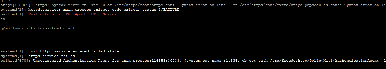

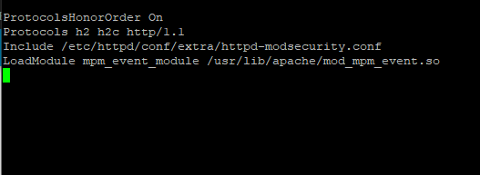

I rebuild all and everything works.
But i have only problem with start httpd.
When i enabled option mod_security my httpd doesnt wanna start.
I rebuild all
I rebuilt the environment etc but the problem persists. I'm not a newbie. I have installed directadmin many times.
I rebuild all
May you pm me access to it? I’d check it free of charge :)
