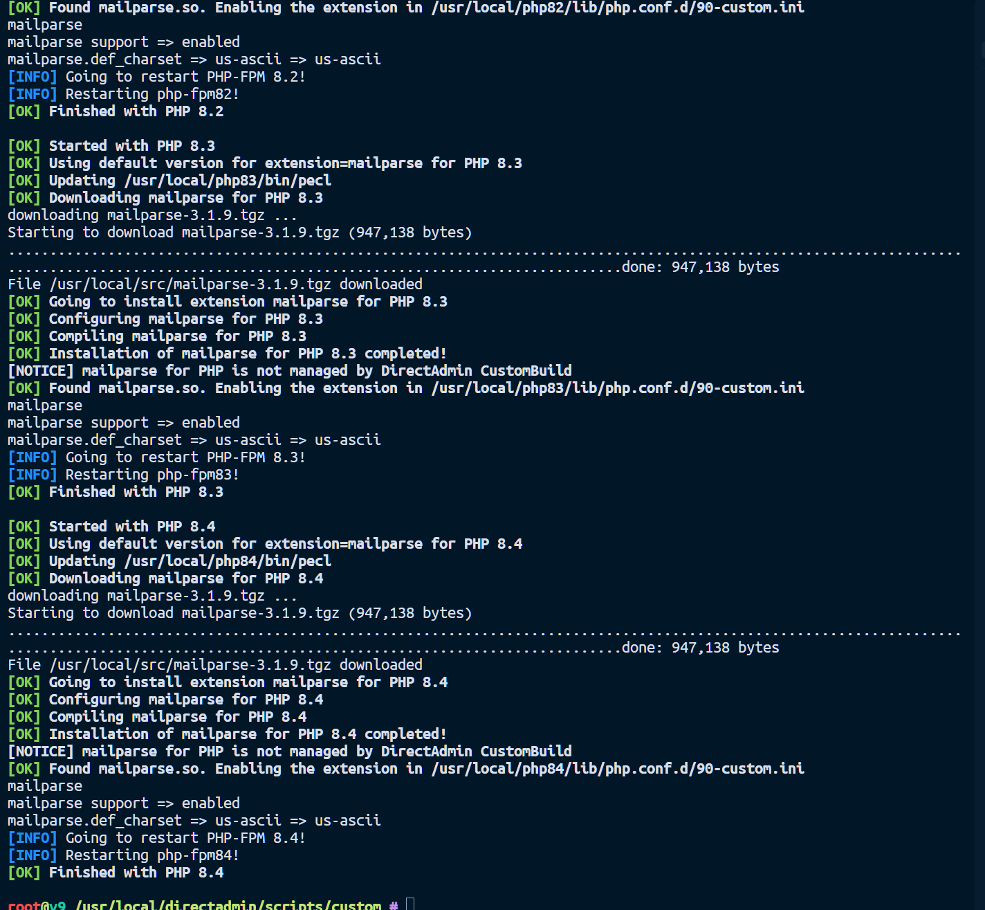

M microz Verified User Joined Jun 10, 2009 Messages 124 Location Santiago, Chile Apr 26, 2015 #1 Hi, It's possible build php with PHP Mailparse PECL extension enabled with custombuild 2? Rgds, Eduardo

zEitEr Super Moderator Joined Apr 11, 2005 Messages 15,143 Location GMT +7.00 Apr 28, 2015 #2 Hello, You should install PHP Mailparse extension with pecl. You can use this guide http://help.directadmin.com/item.php?id=400 it describes how to install APC extension; commands in the step (1) are almost the same if you install Mailparse.

zEitEr Super Moderator Joined Apr 11, 2005 Messages 15,143 Location GMT +7.00 Mar 31, 2020 #4 more examples: https://help.poralix.com/articles/install-pecl-extension-for-php-directadmin-server more pages: https://www.google.com/search?q=mailparse+site:directadmin.com

J Jstuts5797 Verified User Joined Mar 8, 2020 Messages 9 Mar 31, 2020 #5 This worked for me, thanks a ton!
