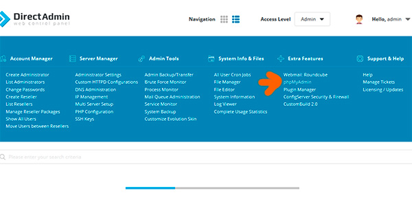

Iam talking about this link in the menu Extra Features under Admin access.
I need to enable something to this work from there?

@bdacus01 thanks, If i se to phpmyadmin_public= Yes works and redirects from directadmin to
https://server.domain.com/phpmyadmin/
But this is not a bug?
Because i cant access from directadmin if i have "no"?
Setting this option to "no" would make-it available only from directadmin (Single-sign-on)
This quote its from the help in the CustomBuild!
Regards

Public yes means the link outside of the panel /phpmyadmin , the admin area and user area.
public no means
Not outside link /phpmyadmin, not admin and only in user area.
it’s a feature for hosters who want more security and privacy for the user.
The single sign on is only in the MySQL database area. See it that works for admin too.
