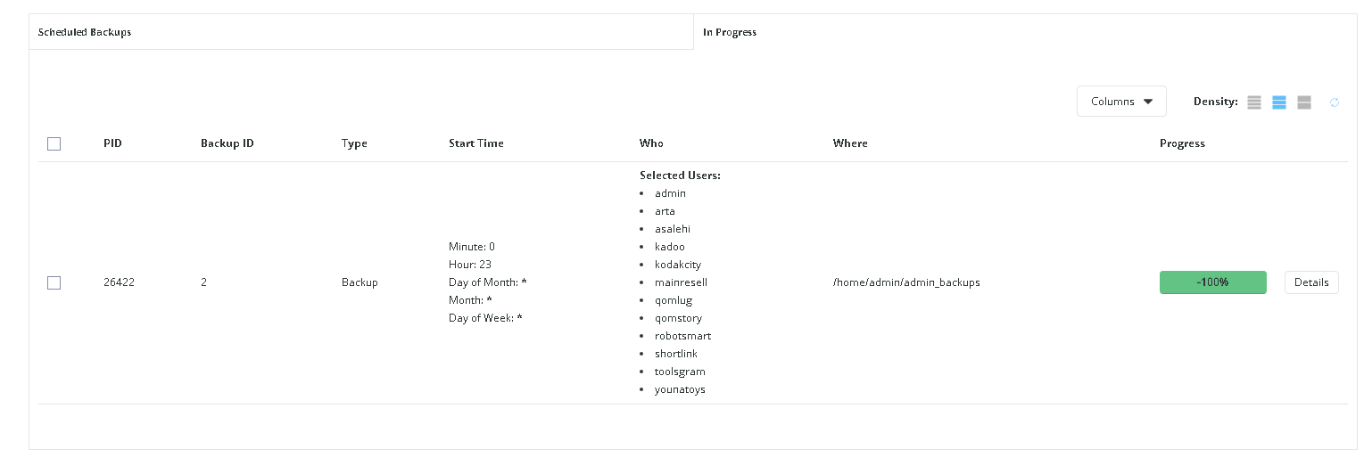

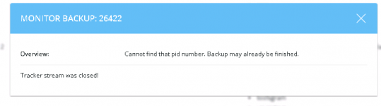

Hello
Finally, when I try to back up Direct Admin accounts at the admin level, I get an error.
1 - Percent is shown as -100%
2 - DirectAdmin General Discussion
Images attached
After the backup operation, the ongoing tab appears irregularly and shows the above and is not done locally and ftp.
In the last few days, a full backup has been taken regularly on ftp. The latest backup files have been encountered and will not be recovered directly from Direct Admin.
Best Regard

thanks for reply
The values of the log files are as follows
