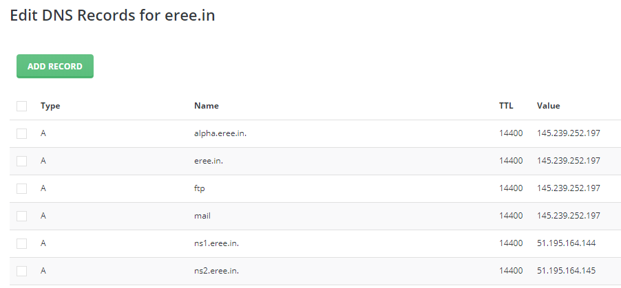

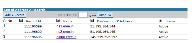

Here, I added the A record for the hostname and the nameservers as well:
I added them in domain registrar's DNS setting as well

Your nameservers are not reachable which is the reason it's down now.
You should be able to SSH via the ip address of your machine. Check if DNS is running.
If yes, check that port 53 is open on your firewall so the nameservers can be reached again.

However. It seems your registrar or host is not routing to your nameservers:
[root@server23: ~]# nslookup ns1.eree.in
;; Got SERVFAIL reply from 1.1.1.1, trying next server
;; Got SERVFAIL reply from 127.0.0.1, trying next server
;; connection timed out; no servers could be reached
Contact your registrar or host or datacenter who takes care of your nameservers if they worked before.
Something is wrong there it seems.
