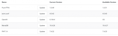

Hello, in DA (1.645) Service Monitor I have 2 stopped services:
  1. clamav-freshclam
  2. clamd@scan
When I try to run that services, there are errors:
Cannot find the script in /etc/systemd/system, /usr/lib/systemd/system, nor /lib/systemd/system
/lib/systemd/system/clamav-freshclam.service
/lib/systemd/system/[email protected]
At this moment in CustomBuild options I have ClamAV-related Settings -> all set to "no".
Also I cant remove that services and the message system send to me SPAM mails about services currently down.
This all happen when I update ClamAV from 0.104.4 to "OS" by CustomBuild (also exim.conf from 4.5.42 to 4.5.43). Maybe downgrade will solve the problem ?
Can someone help ?

Thanks to user @Active8 we now know the root cause. You should migrate to AlmaLinux 8 as there're no official repositories for CentOS 8. The migration is rather straight-forward. You might do it yourself.
Thanks You ALL guys, the system is upgraded to AlmaLinux without any problems.
