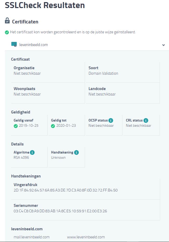

That's nice, but I really just want the SSL for the user domains (mediacs.nl, leveninbeeld.com, akoesta.rocks) to work out, and they don't (see attachment).

You should configure IPv6 correct on your server. There is no issue with certificates over IPv4, and the issue is reported only over IPv6. It might be because you don't have IPv6 assigned to your users domains in Apache, but have the IPv6 records in DNS.

Thanks, I don't see any warnings using the sslshopper tool, that's strange.
I checked IP management, the ip6 address was there. I can only asign 'admin' (admin user) there, and when I do it puts admin in the reseller column.
I also added a screenshot with the DNS settings of my vps provider, I use their nameservers.
