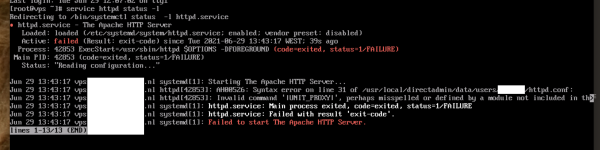

connect console with root access and type
service httpd status -l
Post output here
(Don't post any sensitive data)
if print something like "UNIT_PROXY" there have relate thread to fix that error
move it to here
Thanks, that seems to fix it.
/usr/local/directadmin/directadmin p
./build rewrite_confs
./build update
./build apache
