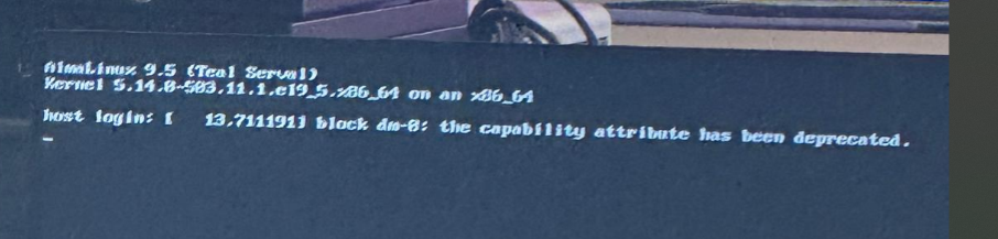

Thanks, understood but it is not the case. Looks like software issue in AL9 or in DA in conjunction with AL9. Now, I am trying to reinstall, on the same machine that worked the past 2 years, Dell server, fresh AL9. After reboot I get this message and server does not connect to network. I am sure problem is AL related. I wonder what is causing that.
LATER EDIT: Looks like there is a problem with mounting a separate data drive for backups, fstab syntax is not the same, now drive is required to be identified by UID, not sdb...sdc...etc. I suspect this is the cause for boot failure with "emergency mode" message. Something became deprecated in old installs.
That could be easily tested by commenting out that mount, put a # in front of it in the /etc/fstab and then see if booting works again.

Yes you can do that if you can login, but some cases you cannot login locally on the machine. Yet not clear what is it, it may be due to new HDD register system in fstab based on drive UUID not on drive name (sdb...sdc...etc). Looks like (according to some posts) that server may mistankely change drive name while rebooting. Then, system goes into emergency mode like mine and I cannot escape from there. I know there is a way, I just don't know it. I registered second drive based on UUID in fstab now and one of dead fellows started. Will keep digging. I have another server still working old style. I guess I have to avoid rebooting. And yes, I am no expert, but seems to be OS issue not DA.
Just FYI, this is how last line in fstab is looking now, the one loading additional drive.
UUID=b0252b79-9255-4d7b-8127-7b56a169ffda /BACKUP xfs defaults 0 0
old style was like that:
/dev/sdb1 /BACKUP ext4 defaults 0 0
Normally from rescue mode you can login to rescue mode or use KVM from datacenter. And then you have to mount the drive manually. After mounting you can change the required files.
But if you even can not login to rescue mode of via KVM then it's a real problem.
Normally both UUID or /dev/sdX should work but it's way better and safer to use UUID as /dev/sdb etc. is a very old method and can also cause other odd issues.
