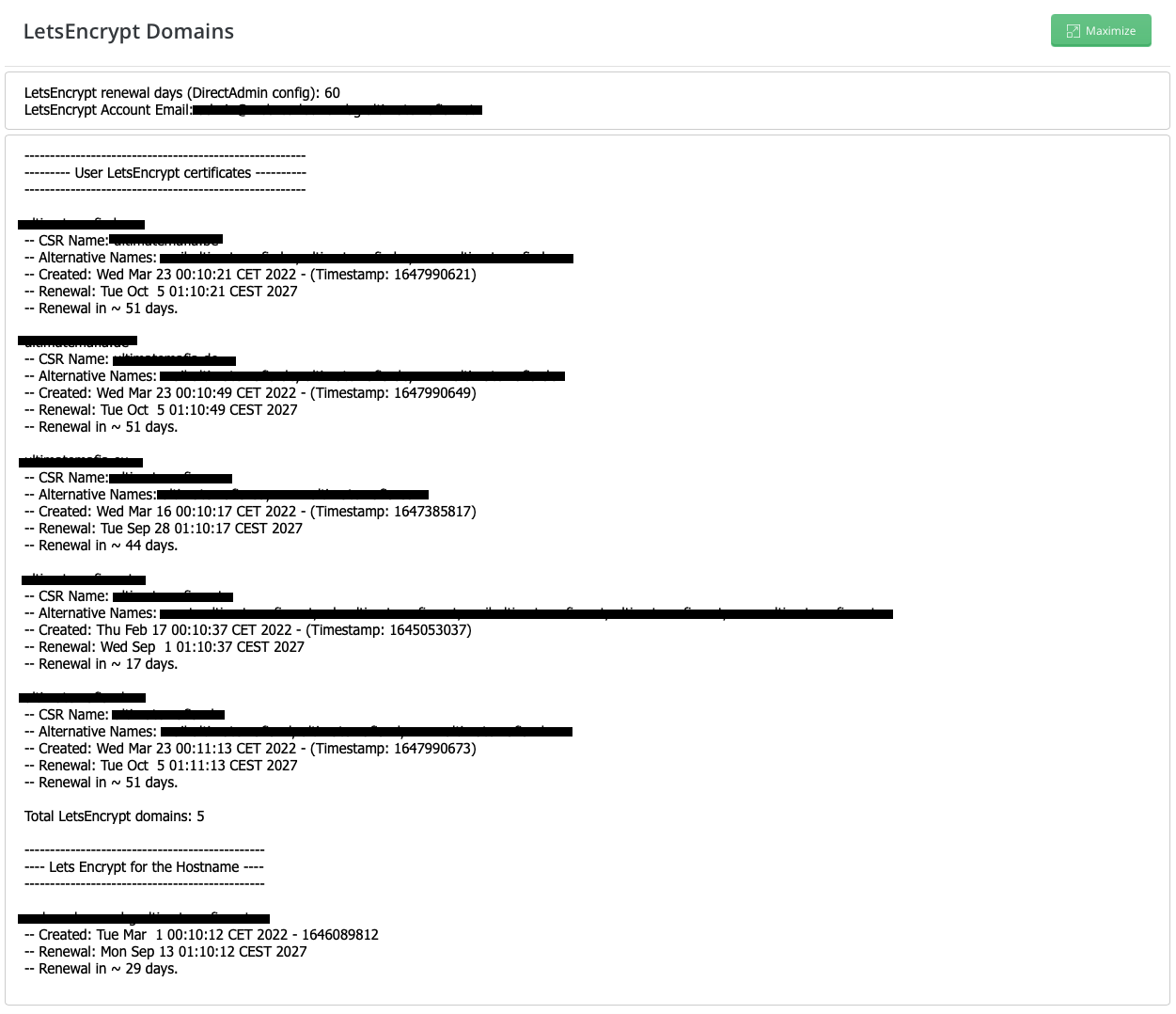

Plugin for easily displaying all domains on the server with active LetsEncrypt domains with the renewal dates.
Is it free?
Yes.
Screenshot:

If you can test it that would be great (y). After install it appears like usual under Extra Features. It works without issues here on the Evolution skin. Later I will improve syntax highlighting.
Oke installed, and found a display issue.
Looks very nice.
But it only shows 10 domains to me, when I want to see the rest, scrolling my browser bar won't do any good because that's already at the end. I have to click in the section and then have to use my cursor to scroll down.
When I look at CSF, you can use the browser bar to scroll down.
It looks as if the LE list is devided into 2 blocks, the main head containing this:
LetsEncrypt renewal days (DirectAdmin config): 60
LetsEncrypt Account Email: [email protected]
Then a middle section with all domains and dates and so on. You have to click in this section to see all rest of the domains.
Maybe this can be fixed by some css code or something, I don't know.
I'm already happy with this anyway. :)
So it's just a suggestion if you have time left.
Oh this is great, the plugin manager even showed there was an update. From 1.0 to 1.2 if I've seen it correctly.
Working perfectly now, thank you!! (y)(y)
