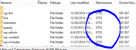

I have a problem, how can I do?
Please help me... :(
I use Filezilla CHMOD file and folder permissions but not be changed.
Status: Set permissions of '/domains/huanlu*********.vn/public_html/wp-admin' to '555'
Command: SITE CHMOD 555 wp-admin
Response: 200 Permissions changed on wp-admin
Status: Retrieving directory listing...
Command: PASV
Response: 227 Entering Passive Mode (115,146,127,39,138,181)
Command: MLSD
Response: 150 Accepted data connection
Response: 226-Options: -a -l
Response: 226 25 matches total
Status: Directory listing successful
But check it is still not saved
If I perform on DirectAdmin it still works?
Can you help me?
With CB 1.2 I see
Changed permission OK
CB 2.0
Can't change permission
Thanks!

Looking at the code for pure-ftpd it is checking if you are changing the permissions of a directory and if you are, then it automatically changes the owner permissions to 7, so if you were trying to change a directory to 555 it would change it to 755 which is what it looks like in your image. A file should be able to be changed 555 based on the code I am looking at (src/ftpd.c starting at line 2589).
