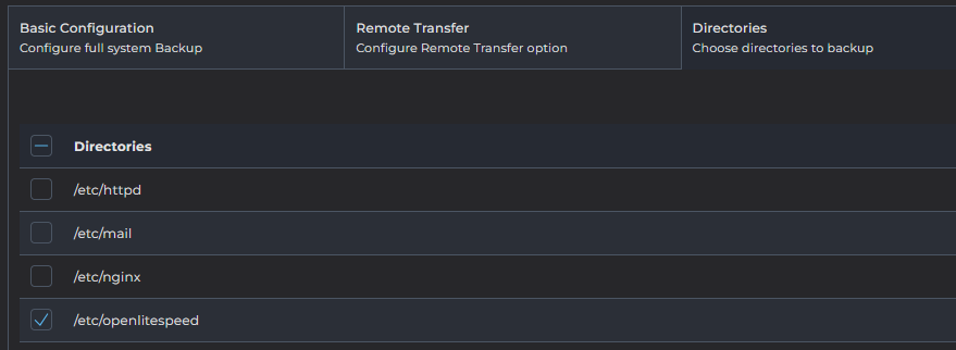

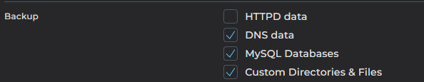

Okay, I found a solution.
In "System Backup" on first tab uncheck httpd data.
On third tab check /etc/openlitespeed
Press "Save".
I would have expected on the first tab that httpd data automatically was replaced with openlitespeed because this is set with CB.
Edit: it seems at the bottom of the third tab you have to add manually: "/etc/openlitespeed". Then it appears in the list.
