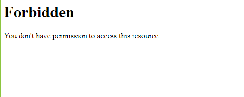

Im getting this:
Ha. Funny. That is not an error log. You seem to not be an admin. You should contact your hosting company.
I’m admin. But I can’t get it to work not matter how I try to redirect folders :(

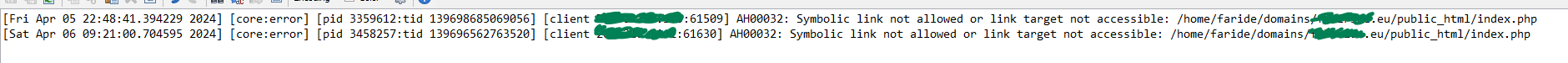

Hi, @Richard G
I'm getting this:
I tried to create shortcut to the public_html - it did not worked. Tried to create create shortcuts to every file in the main domain public_html. Still not working.
I get it working only on simple index.html file when I created shortcut on second domain to the main domain index.html file.
Now Im trying to do the same for WP website. But it not working :(
Hi, @Richard G
I'm getting this:
Now you have you answer. Either the symbolic link is not allowed or does not exist.
Can you
ls -l /home/faride/domains/xxx.eu/public_html/index.php
What happens when you ls the symbolic link?
