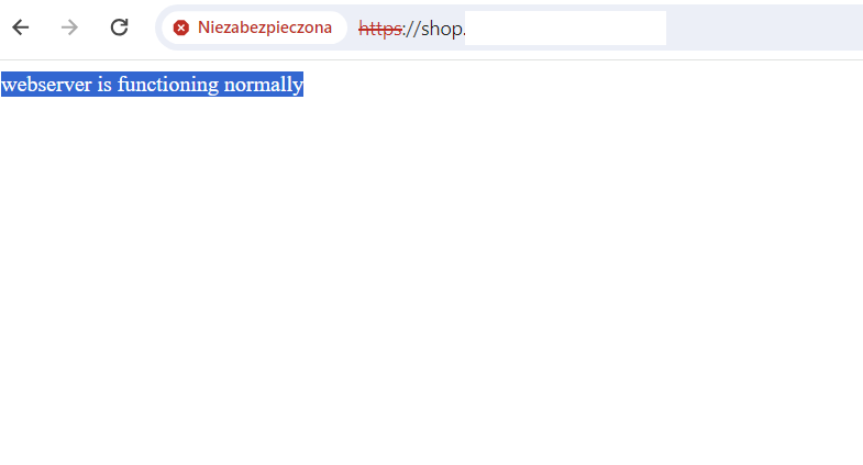

@jamgames2 now i make some test base on your replies, and now result is:
I totally disabled CloudFlare for first resolve issue in server, and now I can access correct to node app from domain with http and working.
but when I try access with https:// then i not have now 502 bad gateway but i have only
webserver is functioning normally without see app:
I use your tip for proxy pass, so now looks like my app is not available under "https" ? If yes, i research most of topics in network, and there is no information about "run nextjs under https". Always are running node app in standard and then proxy pass both http and https and should working in both, but in my case not working and im not sure what is goin wrong.
in your case, you proxy_pass with "https", but your node app doesn't support "https" protocol.
I already mention in my reply #5.
Full custom template to proxy_pass as "http" protocol or work hard to make https protocol to work correctly on your node app.
