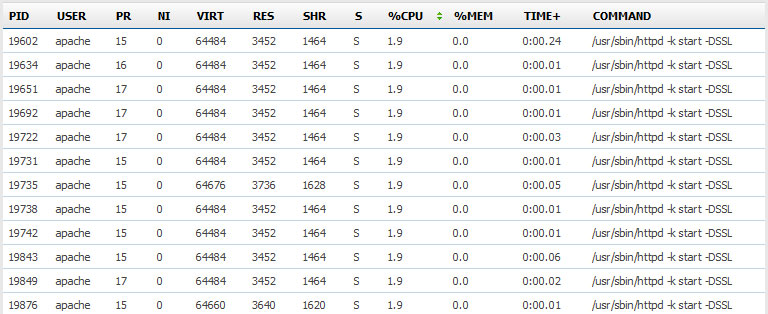

a lot Httpd process by: /usr/sbin/httpd -k start -DSSL
iMasoud
Mar 13, 2012
9
i'm getting a lot of httpd process in : /usr/sbin/httpd -k start -DSSL
what is this processes? how can i stop it?
it use all of my CPU :(
Reagrds,
Masoud
There is either a DDoS/HTTP-Flood/Bot attack or you've got a high-load site. Check apache server-status page for details and read apache common and per virtual host logs.

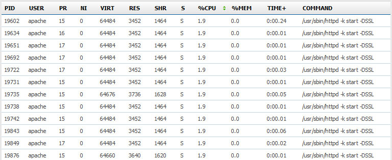

Reagrds,
Masoud
How many processess do you have?
Apache will start a predefined number of processess to serve to new visitors. In your httpd.conf you can set this number of processess to start.
Do you have root access? Use strace process number.
You can use apache-status page to see what page they are visiting.
Install mod_ruid2 or php-fpm to serve each apache process under accountname
