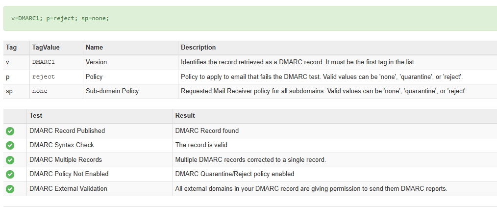

Tested it using DMARC tester on mxtoolbox.com and the result as per below:
