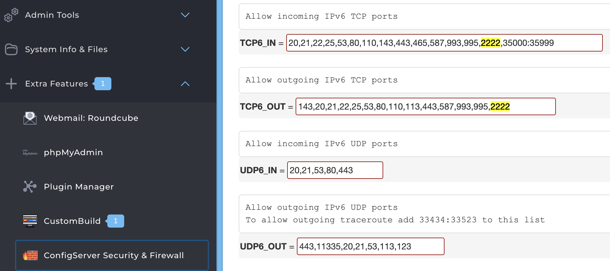

i have installed directadmin on a new server. all is working. but i want directadmin only to be avail on ipv4 and not ipv6. while still the email server can use both.
for security i have a firewall outside of the server that controls access but it cant do port control on ipv6.
i hae disabled ipv6 in the config but that does not seems to work correctly.
For example, if your DA server has "ConfigServer Security & Firewall", you can remove port 2222 on IPv6 like in this image below.
