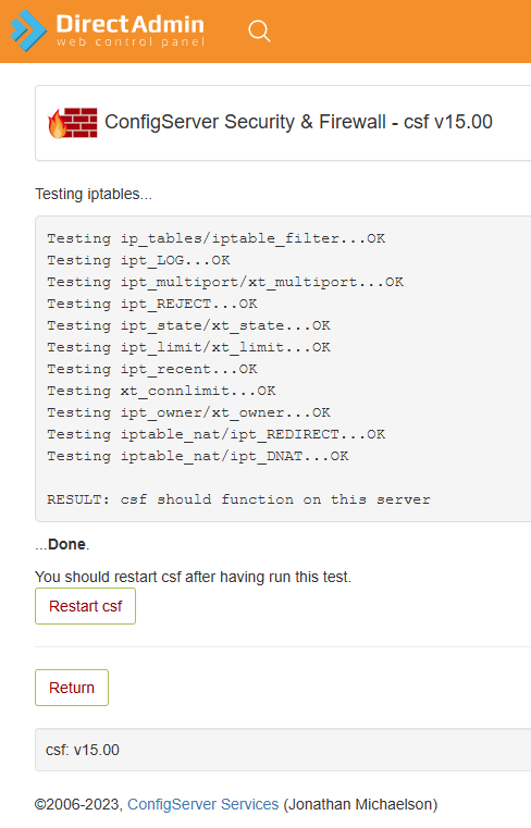

I can confirm CSF still works on Almalinux 10:
