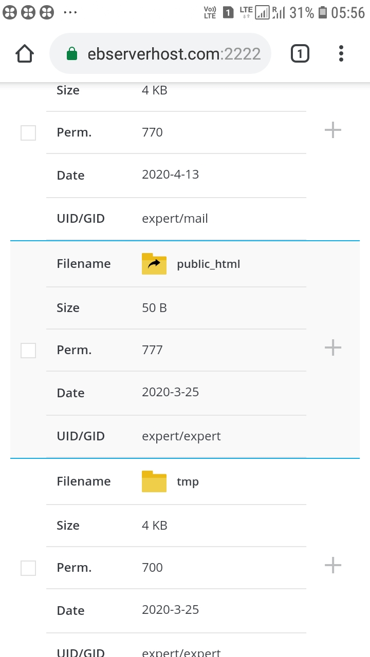

All account on my directadmin have public_html
permission 777 and also the new account with the same permission is it normal? Please see the attachment.
If you use SSL for your domains, then they'll need to load from private_html. Some will enable SSL, and if the symlink between public_html and private_html doesn't exist, it will try to load the site content from private_html and give a message to upload the site content to private_html. It is best to have the public_html -> private_html symlink enabled by default to prevent this problem.

In my server, private_html is 777 as are all symlinks and public_html is 755:
lrwxrwxrwx 1 admin admin 13 Sep 28 2019 private_html -> ./public_html
drwxr-xr-x 3 admin admin 4096 Sep 27 2019 public_html

It'd like to note it's permissions of a shortcut (symlink) :) Actual folder (not shortcut) permissions are in effect when accessing the files.

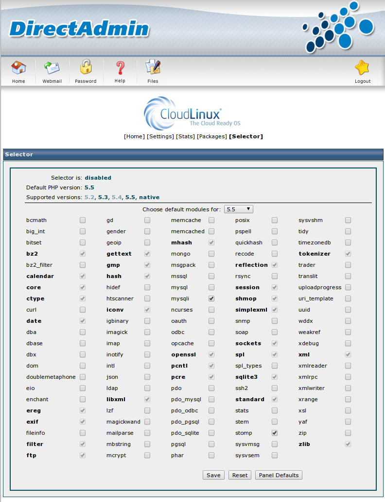

The feature you are looking for is possible when using CloudLinux.

DirectAdmin developers are listening to feature requests. They’ve pushed out more features in the past 6 months than I could’ve ever imagined possible. Keep voicing your opinions and add to feature requests to let them know what’s important to you!
Yes I know done a lot like single sign on, file manager etc for better user experience , ini editor is pretty important for developers. I got 10 requests for this by developers and they shifted to cpanel because of this.
I haven't seen this what you have on Cloudlinux for selection on cPanel either, so good luck for those devs then.
