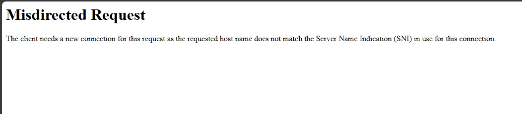

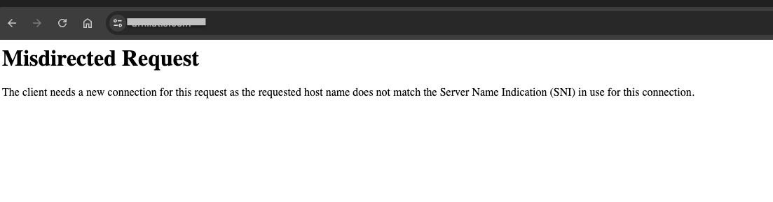

All the sites on my server are experiencing this error. This is the first time this has happened to me in 12 years of working.
Can anyone help me?

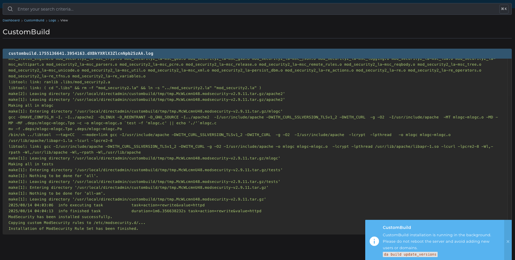

Custom Build > Versions > Apache > Manually set version 2.4.63
I reported this early on - it was issue with 2.4.64 Apache and nginx_apache webserver but apache webserver appears to work ok.
I temporarily worked around it for a couple of sites running through Cloudflare by changing the SSL encryption mode to Flexible which works but then all communication between your server and cloudflare is done over http instead of https.
I also rolled back to 2.4.63 until it can get sorted.
