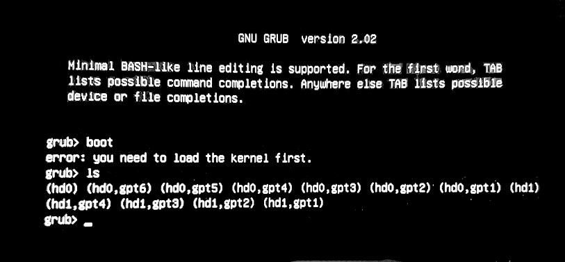

This is fresh install ISO and do first update.
Anyone encouter when updating via "dnf update" and reboot then it's not boot, "grub>" terminal show instead ?
So lucky this is just my test server 😅
it's be something like this
###To fixed this problem ###
#fresh install from ISO and execute these command
reboot # Ensure new installed from ISO should working fine.
dnf update grub2-common -y
grub2-install /dev/xvda #this command should return "no error"
reboot # Ensure new "grub2" should working fine.
this is fresh install from ISO, only 1 command execute "dnf update" and reboot.

Ahhhh, after spend times 24hr, now I can fixed this issued.
The issued happending when running VM on some cloud software, so "grub2-install {device}" can solved the problem after updated the new version of "grub2-common".

I use virtual machine with legacy boot.
I have dedicated server with cloud software installed something like... xcpNG or proxmox, so I can create the Virtual Machine and can remote access to any VM.
in my case, boot with rescue mode using Linux ISO and mount partition and you can running the command to fixed the issues.
p.s. I still don't know why upgrade the "grub2-common" will breaking the boot operation, so this fixed is just workaround 😅
