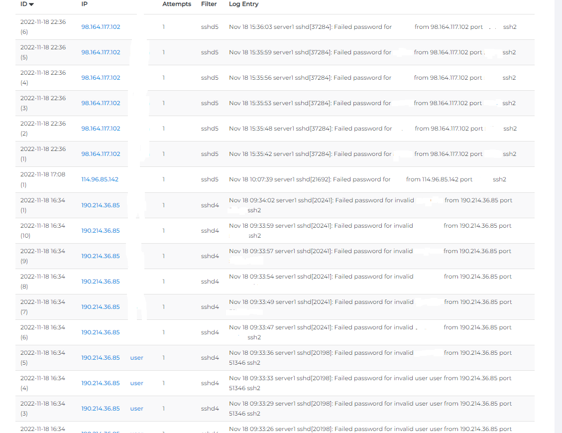

there are a lot of strange IP addresses that have been trying to login to my directadmin account.
Do I need to block these IPs?
How much can IP block be.
Please just me thank you.
your SSH is hammered, normal behavior for default port:
1. change your default SSH port
2. give only your fixed IP access to your SSH
3. disable password auth. use SSH key
DA login attempts will be placed on blacklist automatically
Looks like a distributed attack on your SSH port. You can block the ip's. Normally if you use csf/lfd it will block for you.
Ah Active8 just wrote the answer to your question. I always use ssh key.

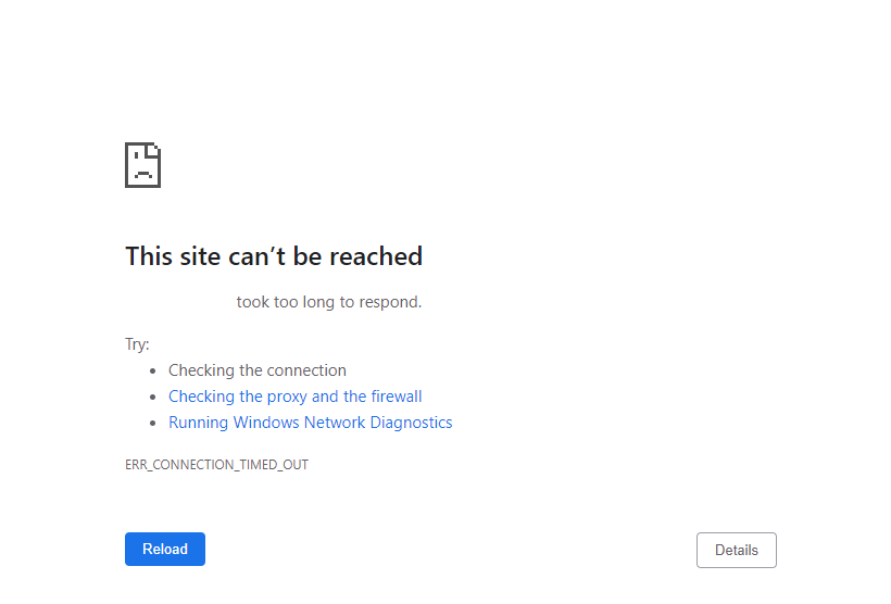

yes DA already has a server IP.
I added to my network PC IP and got the same error as above.
you added to server interface your home IP as additional server IP? it will not work. it can drop your network on server.
if you still have access through ssh - log in an shutdown this IP and remove from interface.
I had to reinstall DA.
