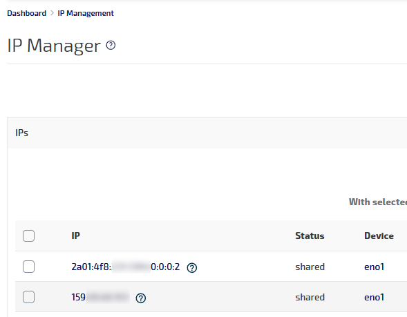

In path: cat /usr/local/directadmin/data/admin/ips/
I have 3 IP's listed, server IPv4, shared IPv4, and shared IPv6.
Currently shared IPv4 is has linked_ips directing to.. something, from control panel this is IPv6.
As reseller/admin I have set up the IP to be linked and global. And I have been able to add the IPv6 as additional IP for the client(s).

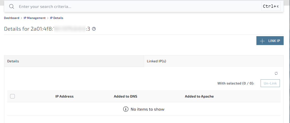

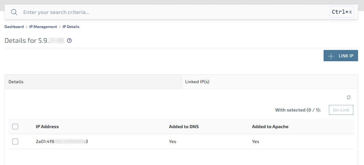

I initially read the official instruction that specify that you must click IPv6 and link it to IPv4, but today reading the comments it seems this is false information and you must link Server IPv4 into Shared IPv6, but then another official source specifically mentions not to link shared IPv4s with server IPv4's. So.. this part certainly requires extra clarification in the documents. That being said, I have tried all possible combinations with linking IP's and none of them gets me anywhere. There was even time when IPv6 was linked to IPv4 which was linked back to IPv6.
I might also suggest that the "Link IP" user interface should be more clear what linking does, which way data propagates, and maybe even give example or few how to use or properly in some info section
